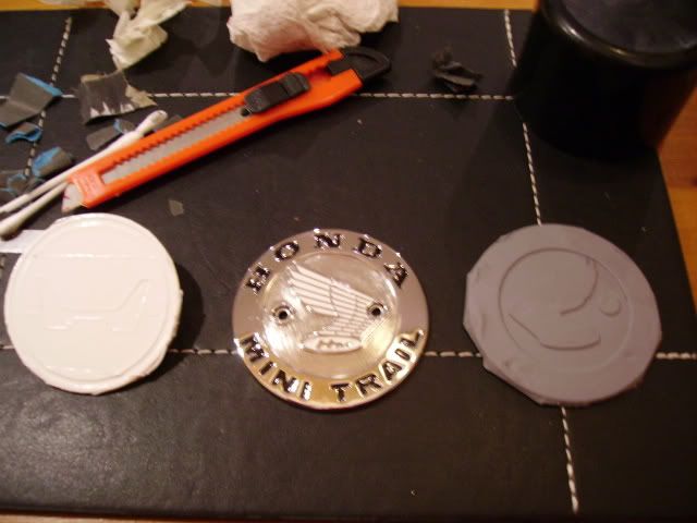

I've had my original z50a badges (2 x round tank & 1 round headlight) stripped & rechromed:D the only problem now is painting them up, so I started with the round headlight one , the white around the outside & in the "H" is still on from original so I only need to paint the middle red, but with it being rechromed I'm having problems getting the paint to stick:rolleyes:
I've cleaned the badge with panel wipe but I'm suspecting i'll need to rough up the chrome to be painted over:confused: if so how the hell am I going to do the tank badges:oops:

You need to scuff up or etch the chrome so the paint will stick. How you plan on doing that in those tiny areas won't be an easy task.
Who said anything about bodging the paint:confused:
I can get the spray paint to stick now, the small detailing parts ie the white wing bits will be painted in by my uncle who's an artist. I'll post pictures when they're finnished.

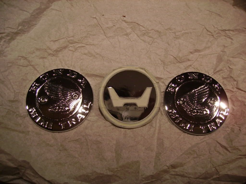

Happy new year all. Now Crimbo's out of the way I cracked on with the badges, here they are stripped down & chromed up, the headlight badge still has the enamel white paint on which was wet & dried down until it came up well, just put masking tape on ready for etch primer & red paint.

Black enamel paint in the "Honda Minitrail" bit & white enamel in the wings with all the chrome bits on the wings buffed up.

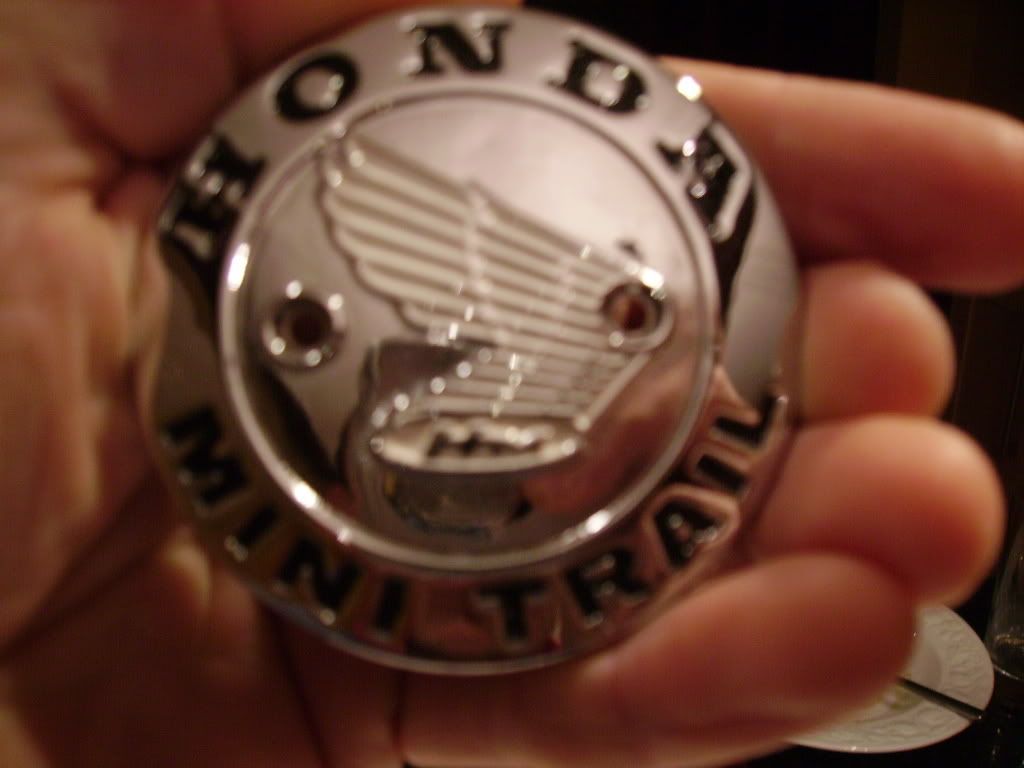

A close up, sorry it's a bit blurred. More pics to follow when the red bits are done, All nice & original:D

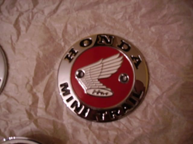

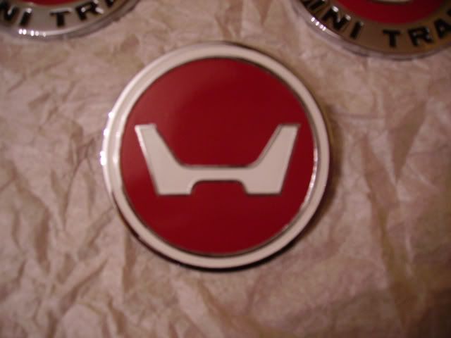

All finished, 100% genuine badges fully restored & I must say I'm pretty pleased with myself.:D

Discussion Starter · #20 ·
The fihished badges
The hardest part was getting the red paint in, I had to let it marginally over spray onto the chrome, then scalpel very steady where I wanted the red to stop the scrape the overspray off....
The paint is all enamel the black & white being touched in with a brush & letting it flow into the recessed bits. The red was sprayed.
