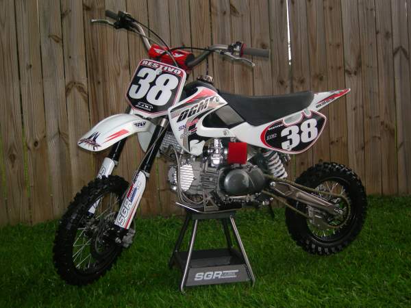

Re: mounting a tb28 carb on yx160
here one with a tm28 on it
